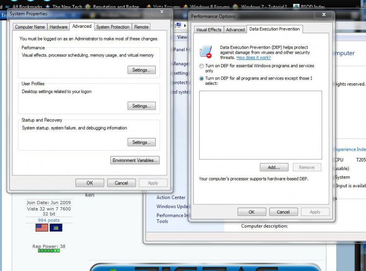

app crashes are often caused by DEP misconfiguration. dep, or data execution prevention is located in control panel>system cpanel>advanced settings>performance settings>dep and should be ON for all programs.
let us know if it is

Hmm it was only on for windows programs etc. though that's the way it came.
