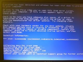

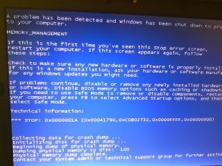

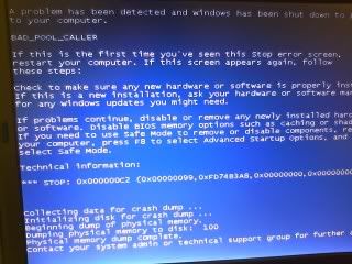

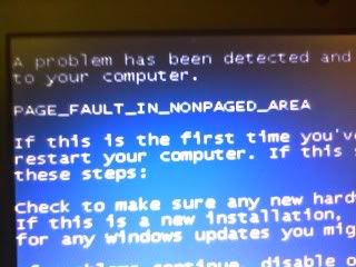

I read the instructions on what to post when asking for help with blue screen but unfortunately my computer doesnt stay normal long enough for me to run all that stuff. I have attached pictures of the different blue screen errors i get.Like i said computer starts and i get to put in my password and maybe works for 5 mins and i get kicked off and blue screen comes on.
I have a Dell Latitude D630 running Vista Business its about 3years old and when i first got the blue screen i opted for re installing my OS using my recovery disc so the laptop is basically back to how it came.
I have heard different solutions but i dont know what to go for do i need to replace my MemoryRam or my hard drive.

STOP 0x0000001A: MEMORY_MANAGEMENT Usual causes: Device driver, memory, kernel
<H4>STOP 0x000000C2: BAD_POOL_CALLERUsual causes: Device driver, ?Memory
Without those reports, there is very little that I can do. That being said, I was able to see C2 and 1A, if you have others let me know. Your eyes are probably better than mine.
In any event what we have indicates memory or driver. I think its memory, since you used the recovery DVD and still have the problem.
I cant give you a memory test or any other test since your computer will not allow it.
See how it runs in safe mode, maybe we can work from there.

You did well my friend. There are a lot of reports to check. I will finish the analyisis and report later. One area that has to be checked is memory. You can start on that now
Guide to using Memtest86+
i went ahead and bought a new 1gb memory and took out both of the ones i had and so far no blue screen yet hopefully this is just it.
