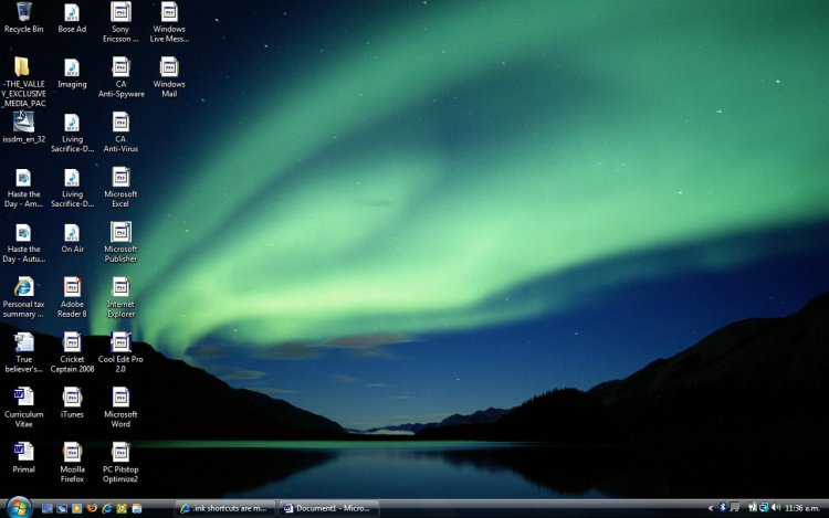

My desktop icons are not working correctly the applications are working fine but the icons are all the same attached is a jpeg of what it looks like as it is hard to explain the problem.

It looks like you may have used the improper method for XP to remove the shortcut arrow in VIsta. You will just need to restore the shortcut arrow from the link posted by mansrm81 above, then you can remove it with same program if you like. :)
Hey it seems not to be working correctly i just remembered that when the first error occured it was after i installed CA Security Suite. Anyway you can help me?
Have you tried uninstalling CA security suite and see if that fixes your problem.
Many programs do this and uninstalling them no help.By using Vista Shortcut Overlay Manager disable arrows by icons and enable arrows again.

I've tried Vista Shortcut Overlay Manager and several "Tweak" programs. Sadly none have worked. I have no icon problems, just hate those arrows. Short of messing with the registry are there any other options?

That's the improper XP method, that can cause the shortcut icons to have a blank icon instead. I would not recommend to use that one in Vista. :(

You might see if right clicking on the Vista Shortcut Overlay Manager shortcut and clicking on Run as administrator will allow it to work properly afterwards to remove the arrow.

Vista uses this value to track links, if you remove or rename the IsShortCut value lots of programs and features that use links will not work correctly. For example, in Vista the shortcuts in Favorite Links, Media Center, and in the Games Explorer disappear or will not work anymore. :(
