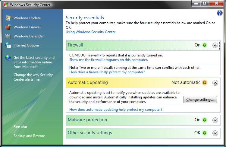

Attracted by the additional outbound protection offered, I decided to install Comodo.
I seem to recall (but may be mistaken) that when I installed Comodo on an XP machine, Comodo automatically switched off the Windows firewall and Windows also recognised that Comodo was installed and had taken the place of the Windows firewall.
Therefore I was surprised that after installing Comodo on my Vista machine that the Windows firewall was still on and when switched off still told me that I had no firewall.
Is this correct behaviour or has my installation not gone correctly?
Also, when I first log on I get a pop-up from Comodo telling me that svchost.exe is trying to access the internet - is that valid and what should my response be to set it permanently recognised as good?

Hi Charlie,
You should turn Windows Firewall off before installing COMODO, but I did not have a problem either way on my system. If you do not have COMODO listed in the Security Center, then I would uninstall it and reinstall it after Windows Firewall is turned off.
svchost.exe is usually a Vista system process, so it should be safe.
Thanks for the quick reply Shawn - you must be an early riser, or a late-to-bedder!
I did a system restore anyway, so I'll give it another try.
