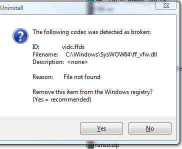

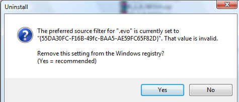

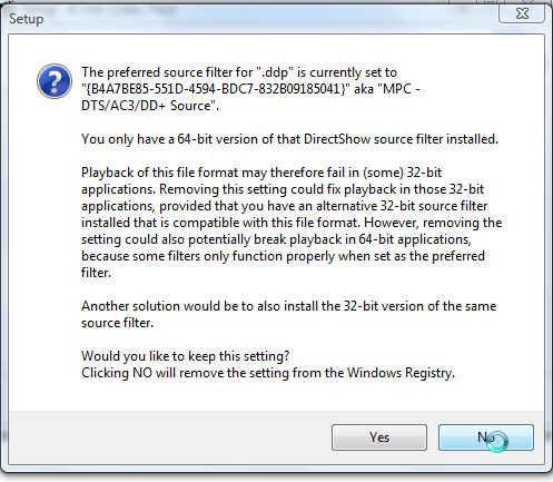

Well Simonc55, I did try that codec you mentioned and it didn't work. And I believe that that codec should be installed with the 32 pack first before installing the 64 version. But anyhow it didn't work. As far a pooch's suggestion I am still looking into it but I don't think I'll have any luck with that. I tried installing wmp6cdcs.exe, wmpcdcs8.exe and wmv9VCMsetup.exe with no luck so far. Now what I am trying do is to uninstall all codecs I have and see if with a process of elimination if I can solve this problem. I did just install K-lite and it showed some problems as it installed such as the following which was a common error message with ddp and ec3 (I don't know what they are but there you go)
And when I uninstalled K-Lite I got the following.
In short I think my main problem is some kind of registry problem but I don't want to mess with that. Ever since I installed Vista back in june I have been having trouble installing 32 bit programs, not all but some. For instance I installed one program that kept saying how many dll and ocx files couldn't be found. And little details of it weren't working as well, so I uninstalled and decided to reinstall it. When that happened certain settngs that I had made in the previous install were still there despite the fact that had uninstalled and deleted the folders several times. According to the creator of said program, I may have a problem with shortcuts. I think he may be correct with that but again that is a regisrty problem. I have used in the past short cut cleaners but no help there. Lastly I am going to use CCleaner and see if that helps.
