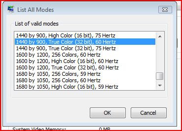

If you go look under display settings click advance, then click on list all modes to see what you can use. i would try resetting your screen settings via the screen itself reset all video settings etc and try again , failing all that , i would try lower screen res and try set refresh rate up then .

pic 2 shows you

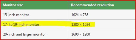

Recommended resolution settings for 17>19'' as 1280/1024 which will for sure give you a refresh rate of 75hertz ,lo i did read your native setting is indeed 1400/900, cant undertstand this , must be based on vid card or something aswell.
Mines is 20'' screen and native res is 1600/1200 @ 60hertz, , i also dont get to choose any higher refresh rate for this res, so for me i have to turn down to 1280/1024 then i get 70,72 & 75hertz available then.
