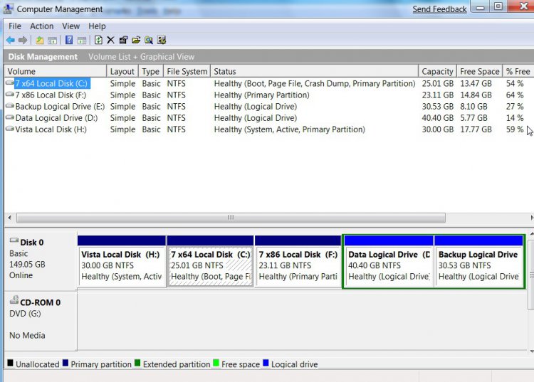

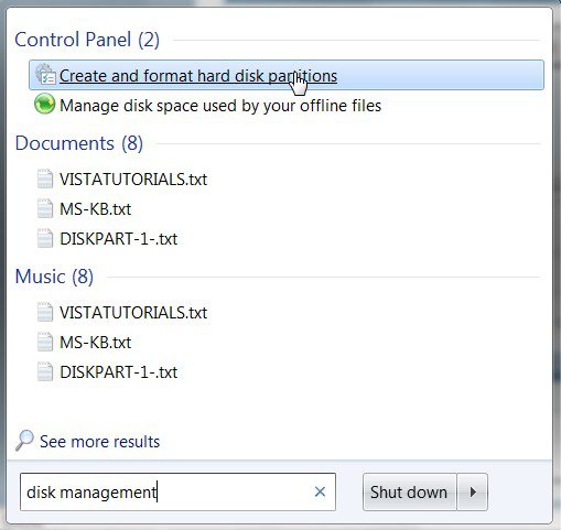

Type Disk Management in start search and click where indicated - it will load up in a couple of seconds:
Then post a screenshot like this:
