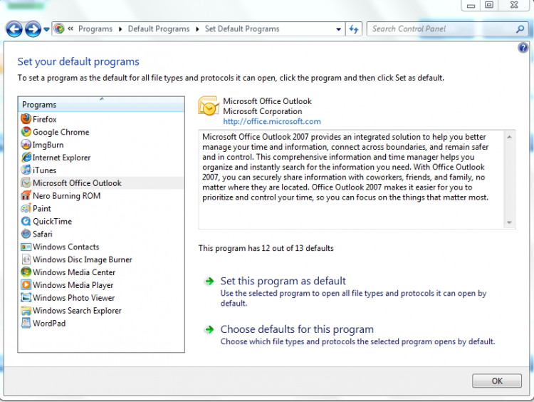

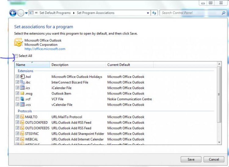

It has something to do with file associations in windows mail.
Click Start>Default Programs. Now look for Windows Mail.
Now click on Choose Defaults for this program.
Check Select All. Click Ok and restart your computer.
(Note: I m currently on windows 7 so options may vary.)
