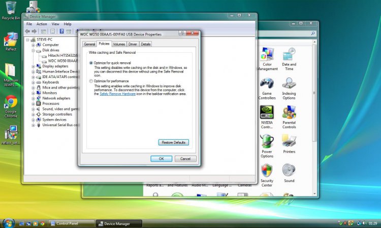

hi
i have just come accross this could it be the cause of the problem?

No, that's not it. But you should "Optimize for performance". Runs faster.
Wait until you shut the system down at night and remove it then. There is some bugger that has a handle on the HDD - nothing unusual.

hi whs so even though OPTIMIZE FOR QUICK REMOVAL is default change to OPTIMIZE FOR PERFORMANCE. but will then need to click safely remove prior to removal to prevent data loss correct? thanks i will give that option a try as it sounds better / faster thanks
do i need to remove after shut down if i have set to OPTIMIZE FOR PERFORMANCE. or only if i keep as OPTIMIZE FOR QUICK REMOVAL?
also how do you mean some bugger has handle (virus?)

If the handles (whoever holds them) are not released, it is safest to remove the disk after shutdown (in both settings). But if you want to take your chances, remove it any time. Nothing bad is probably going to happen.
