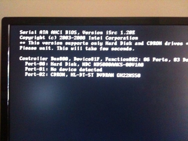

This is what I see when I boot with the problematic HDD on SATA port 3. If I put it on any other port (I have 8) it halts at that point...

So I managed to resolve the problem
Not entirely sure what did it... I fired Gparted Live CD and poked around but did not make any changes nor find any obvious issues. I then booted Windows and ran Paragon partition Manager 10 and looked at the EFI partition and then ran a surface test and checked file integrity. neither posted any errors.
I then shut down, connected via SATA and rebooted system, to my amazement it passed POST and booted OK
Was it something that Paragon did it?? Or was it just a lucky reboot that resolved the issue?? Or perhaps I just managed to hold my tongue in the right place..
Kinda bummed out that I don't KNOW what caused/fixed my issue but I AM happy it is resolved
