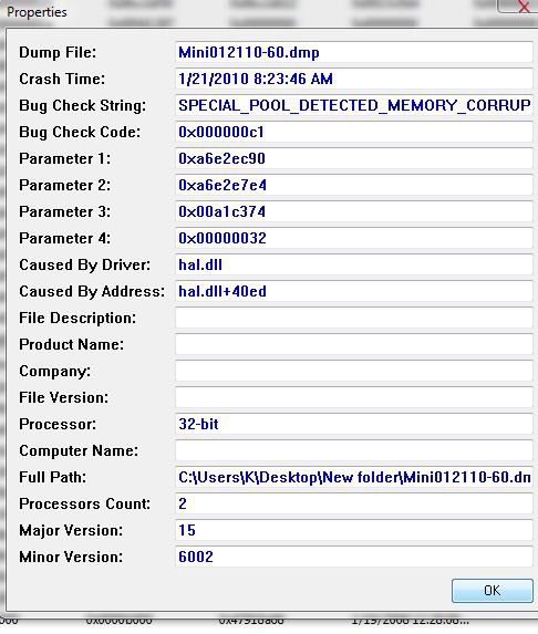

Hi and welcome
these crashes were all caused by hardware, probably memory
I would download memtestx86 and run for 5 passes
run a system file check
(type cmd in search>right click and run as admin>sfc /scannow)
UPDATE THE DRIVER LISTED BELOW
If you are overclocking STOP
Let us know if you need help
Ken

Well, while doing the /scannow it happened again. BSOD!
So after some digging around found some more corsair but only 2x1gb sticks instead of 2x2gb's.
So replaced with these and just gona return the 2gb's back to suppliers and get them to test.
Have also included the latest minidump file if you can check to see if it is the same as the others.

Hi Justin,
Yes it is the same:
STOP: 0x000000c1
SPECIAL_POOL_DETECTED_MEMORY_CORRUPTION
ntkrnlpa.exe + cdb8d
It is also pointing at klif.sys + 395a0. This is usually a Kaspersky Firewall driver, but can also be a virus.
Richard
