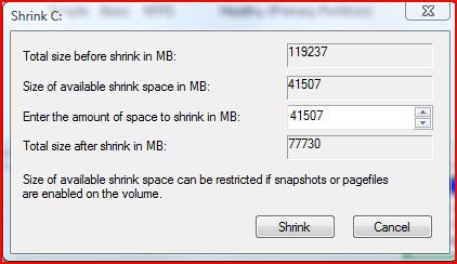

I have been looking through the net and a program to back up a RAID array seems to be very hard to find.
Going back a bit,would it maybe be possible to use a defrag program that will consolidate all the files on your drive allowing you to shrink it more? or even to temporarily reduce page file size?
see capture

I tried that. Ran jkDefrag with optimize. The recovery partition was 13 GB I think. So when I blew it away, I expanded the Vista to the full size. When I tried shrink, it only wants to let me shrink 13 GB. That's after turning off swap, deleting pagefile.sys and doing jkDefrag.

Plus for grins I looked in Disk Management and now it shows me that I can shrink my C: partition down to about 300 GB if I want. When Macrium laid the image back on it must have fixed up my partition table. I had a free space where the restore partition used to be!! Well worth $40!! I think something similar happened to me a couple of years ago. You have to slice off the free space or make a partition or something in advance when you try to make a backup capsule with Paragon. If you just use the wizard and tell it "make a backup capsule" it will say, "sure but you have to reboot now" and then it boots down, but not back up.. and your table is hosed!! I forgot about that. But I remember now!! :)
