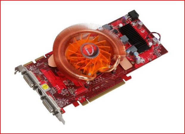

As for heating issues with the 4850, yeah I was aware of it as it was thoroughly discussed in one of the Rage3D forums, which I'm a member. It was determined that the temps (65c ish) were normal operating temps. I still have the stock fan on my card and have never had any heating issues, nor do I use the fan control incorporated in the cat drivers.
On the other hand, my 3870 gave me heating problems and had to be RMA'd. It was during that time that I bought a 4850 and have never looked back at the 3870. In fact VisionTek sent me a brand new single slot 3870 with a ZEROtherm cooler seen here, but I don't use it.
