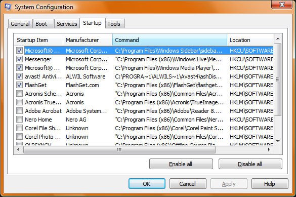

Let's see about getting rid of the startup error message:
  1. Press <WINDOWS_KEY>+<R> to open the RUN dialog
  2. Type "MSCONFIG" (without quotes) and press <ENTER>. You'll need to respond to a UAC prompt
  3. In the System Configuration Window, click on the "Startup" tab
  4. Expand the width of the "Command" column so you can see the command lines better
  5. Find the entries (if any) for all programs trying to run from "C:\Users", and disable them by clearing the checkmark for each particular entry
  6. While you're at it, disable all other unnecessary programs, such as updaters, etc. Try not to disable entries that may be related to your anti-virus software.
  7. Click OK to re-start the computer
If you disabled the correct entries, that message should be gone. If you find that you receive different error messages, then repeat the above procedure and re-enable some of the entries.
If even after all of this you still receive that obscure error message, then we'll look at other places that may be attempting to start an unauthorized program.
Also, do a scan for viruses and malware.

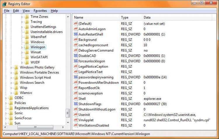

  1. Open Registry Editor. (<WINDOWS_KEY>+<R>, REGEDIT, <ENTER>).
  2. Navigate to the key "HKLM\SOFTWARE\Microsoft\Windows NT\CurrentVersion\Winlogon"
  3. What are the values for "Shell" and "UserInit"?
For now, DON'T change any values.

2.Navigate to the key "HKLM\SOFTWARE\Microsoft\Windows NT\CurrentVersion\Winlogon"
Got to current version but there was no Winlogon just internet.
You sure about that? Without the "WinLogon" key, the computer won't start properly:
The settings you have in WinLogon should be almost the same as what you see in the above screenshot.​

Man my registry does not compare to what you have in yours.
Odd really, as the WinLogon key should be nearly identical for most users.
