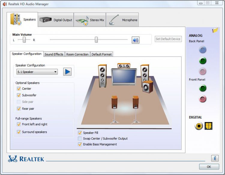

Hey guys, I purchased a Creative Inspire T6100 this summer and I got it to work with my Vista Home Prem x64 for a while, then this past week it just broke on me, what i mean is that I only get stereo quality sound (2 front speakers and center when voice chat is on.) My motherboard is the Asus P5Q-Pro and i am using the onboard sound card which is the Realtek HD audio soundcard on 6.0.1.5591 driver version.
Now i went into the settings already and configured my speaker system to 5.1 surround sound (thats what i did when i bought my system first and it worked fine.) now it wont work. when i press test however, all my speakers work, so it cant be a connectivity problem. it is just when i use itunes to play music or when i play games, or youtube or whatever, i only hear the 2 front speakers, my sub and rear 2 just dont work, only gives out staticy sounds when u listen to them.
Any help is appreciated, thanks!:cry:
Pic here:
http://i36.tinypic.com/21btd9y.jpg
I am not really familiar with Realtek, but check to see the system is automatically switching between the front inputs and the rear when a jack is unplugged. There is a switch in the Real Tech control panel or you can enable this in BIOS on the Asus boards.

This is because music (i.e. mp3) is only stereo not 5.1, so you only hear sound from stereo (front left & right) speakers. Also, you need to set games to use 5.1 in the sound options
This problem can be solved with creative xfi 5.1 cards by opening the the blue audio console, clicking 'x-fi cmss-3d' tab & setting stereo envelopment at 54%.
then by clicking the 'surround' option & choose 'stereo surround' to stop it sounding tinny.

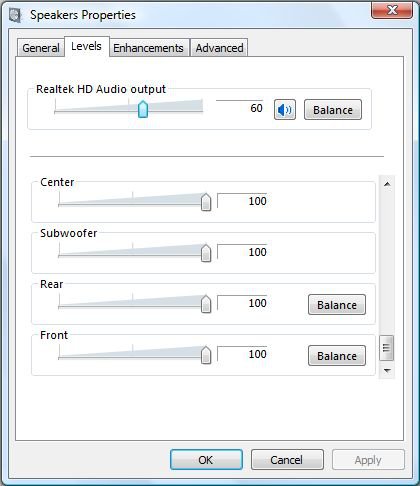

You probably just need to make a few adjustments to your settings. These are the settings that I recommend:
attachment.php
In addition, on the 'Speakers Properties' tab, check the relative levels (and balance) of the speakers.
Don't forget to check the settings on the speakers themselves.
As Michael says, you will get true multi-speaker output ONLY IF the source was encoded that way.
